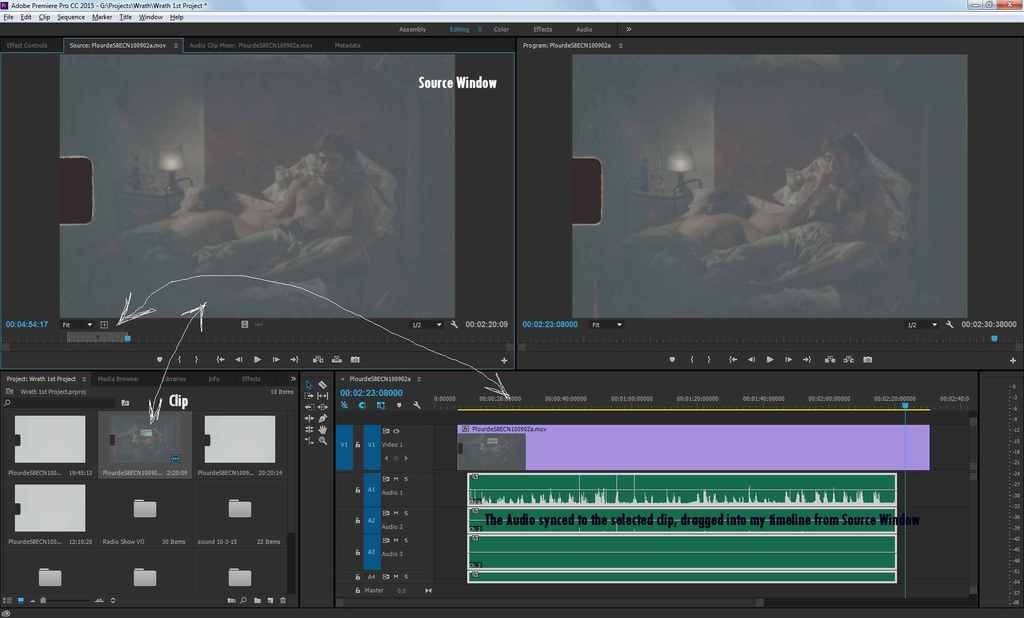

Gents and ladies, this is my first Super8mm project with sync sound and I have four 20 minute ProRes files of my footage. In each 20 minute stretch of footage I will have multiple scenes and takes and each one needs sound synced up. But the only way I know how to do this in Premiere Pro is to select each scene, drag that individual scene into my timeline and then sync. But that would be insane as I would have all of those sequences in my timeline and have to move them around like a jigsaw puzzle (there are 7 takes of the scene featured in the pic below).
So summing up, the sound will ONLY be linked to the clip in the timeline and that's not tenable.
I would like to sync the sound files to each section so that when I put the video in my SOURCE window, the sound is there as well. The sound synced up for each individual clip.
Is this making sense?
Now there must be a way to do this, either in Premiere or maybe Prelude, but I am stumped and have exhausted any all all search options.
I am on a Windows 7 based PC with Adobe CC (latest) so I have Premiere Pro, Prelude, etc. I have never used Prelude as I have just upgraded from CS5.
Here is a screen grab to give you more of an idea. The clip goes from my bin to the SOURCE window. In that clip are many takes. I have selected take 7. I dragged that take into my timeline and synced the sound, but they are not linked in the source. I need to sync sound up for all the clips in that file that is in that source window.

Matthew PlourdeRe: Sound syncing multi-clips in a 20 minute ProRes444 file? Tips please.
by on Oct 30, 2015 at 4:28:45 am
I have but I am not finding it.
What I have found just now is that I can sync the clip and then create a new BIN and drag that clip into it. It appears the scene then links and stays linked in that bin. Is that what you are referring to?
