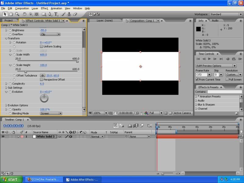

I tried that method, and when I selected the blending mode and then screen, the whole thing went white:

Your comp looked white after apply a blending mode cos' you didn't have another layer below.

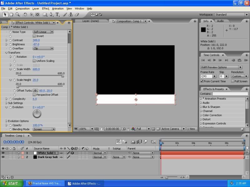

Lower your contrast to about 160-200 - it's way too high and that's why you're getting the full-on white.
And FNoise>Transform>Scale Width should be twice as long or until your lines stretch across the width of the entire comp.
Look at using Levels to increase the luminance of the Fnoise layer rather than the Contrast found in FNoise.

No matter what I try ... I get that result. There's must be some kind of breakdown in communication here, because I followed the instructions explicitly.
As you can see from the photo, the width is as big as it gets ... it can't get much larger than that when it's maxed right out. Furthermore, the bar turns white only after I change the blending mode to "screen." If I leave the settings to either "None" or "Normal" it looks just fine. Not sure what the "screen" blending mode is supposed to do, but clearly it doesn't work from what I posted above. Unless you have an actual screenshot or example, I can't really do anything with those instructions because I end up in the same place everytime, no matter how many times I mess around with the luminance, etc.
