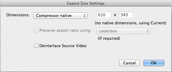

I've attached some screen shots of my export settings. The dimensions are compressor native- 610x343. No matter what I change the dimensions to, the QT player plays in 4:3. This is going to a client for review and eventually being exported to web where it has to be 16:9 to fit correctly in the web player.

You see that "Compressor Native" setting for size? Screw it. Drop it down and go with a custom square-pixel 16x9 setting.
For emailing, I'll export from the FCP timeline using QT conversion, the medium broadband setting, and make a custom size of 480x270, which is 16x9. If you can afford to have a bigger file size and better frame rate, go with the high broadband setting.

I've already tried exporting custom 480x270 and it still comes out in a 4:3 aspect ratio. Should I preserve aspect ratio using crop?
