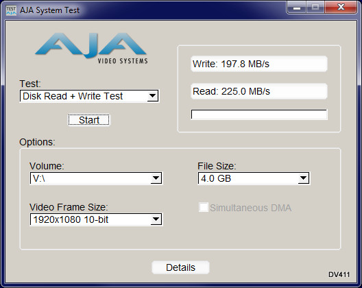

[Michael Garske] "What drives and raid configuration did you have on yours? "
HGST Deskstars 2TB 7K3000 in RAID5 over eSATA.
[Michael Garske] "Also, what were the read/write speeds you observed? Do you think these will be fast enough to edit raw footage from?"
About 200MB/s r/w. The volume is 75% full so these aren't the best numbers. What type of raw footage are we talking about, what camera / file format?
