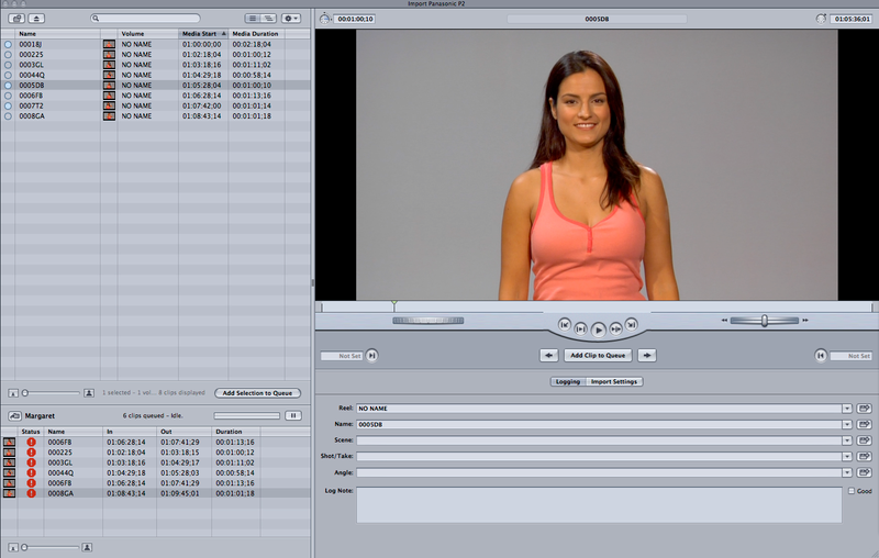

When I attempt to import files from my p2 card, either through a FW400 linked to the HVX or through a card reader, only some of the files will import. here's a screengrab of what it looks like:
When I mouse over the exclamation point I get the message "Error: No Data". Anyone know what the problem could be?

Thanks, I just did, and I had the issue again. I think I've solved it though:
in the log and transfer window, in the 'advanced' drop down menu (looks like a little gear), go to the preferences option, and I had "Remove Advanced Pulldown and Duplicate Frames" checked from a previous project. When I deselected that option everything worked fine.
