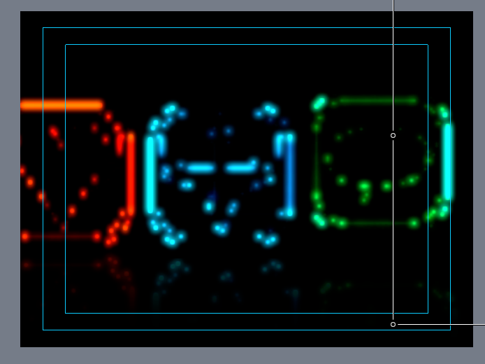

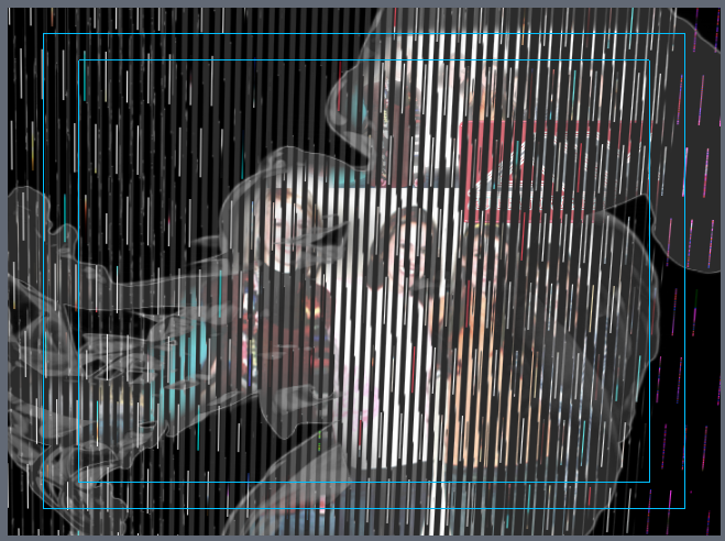

Here are pictures of what I'm seeing inside Motion lately:

David Grimes
Re: Motion Bogs Down (How Can I Fix This?)
on Feb 6, 2009 at 2:26:20 pm
Matt, you mention that in this project you are following something to Audio. What exactly do you mean...is this by you animating to the audio or are you having Motion do it. Motion's audio behavior is very poorly done and can only do limited objects before it starts running into serious cpu issues. If you are using the audio behavior, remove it entirely until your project is done (don't just turn it "off"), then add it and hope for the best. If not, consider shutting off your audio when you don't need it. I find this can make a huge difference in performance.
Good Luck.
-Dave
Matt King
on Feb 17, 2009 at 10:10:10 pm
Okay interesting thing happened.
I started editing using the Standard Layout instead of my own layout and also (I think this is the big thing) I am using only one monitor when I am editing with Motion. Everything seems to be working like it should now. I have edited 2 projects this way and it has not done the floating beach ball on me at all.
Could it be something to do with the video card having a hard time sending stuff to two separate monitors? I don't have this problem when I am editing with FCP.
Thanks for the suggestions folks.
-Matt K
FCP 6.0.4
Motion 3.0.2
JVC GY-HD110
JVC BR-HD 50
Mac OS X 10.5.5
Mac Pro 2 x 3 Dual-Core Intel Xeon 8 GB 667 MHz
Winston A. Cely
on Feb 17, 2009 at 10:15:26 pm
[Matt King] "Could it be something to do with the video card having a hard time sending stuff to two separate monitors? I don't have this problem when I am editing with FCP."
Yes! The graphics card is splitting it's own ram in order to power the two different monitors. Motion is very dependent on the graphics card's ram, while FCP doesn't really care about that graphics stuff.
