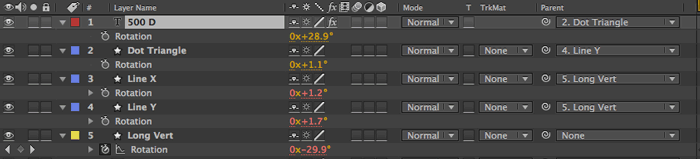

by Nicholas Bentley on Apr 23, 2009 at 1:39:41 pm
So the Expression works really well but I'm trying to do something with it and it doesn't seem to be working for me.
Maybe it's not possible but I thought this is the place to ask if it is.
I'm trying to add multiple cc sphere to a 3d composition and link the lighting controls of each cc sphere to lights in the comp.
The problem is when I duplicate the cc sphere solid and set it back in z space behind another sphere the lighting controls seem to not be able to register the fact the light is being blocked by the sphere in front.
(see images)
after effects preview image
after effects timeline
I don't know 3d, otherwise I'd do it in that way, I'm just trying to find a way to create the illusion of fake 3d for a project I'm currently working on.
Also I'm trying to find a way to make the balls seem a bit reflective (reflecting other balls from the same comp in the surface - as if they where marbles/glass
QUESTION:
1. is it possible to have the lighting controls recognise objects partly blocking the lighting source?
2. how can i make these spheres look more reflective looking/shiny/glossy/marble like.
Advanced thanks for reading this post. Hopefully someone can help out or at lease point me in a decent direction.
