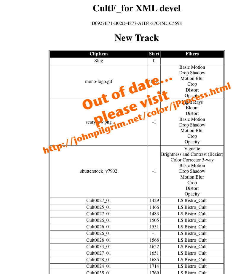

I'm midway through building a tool to help in prepping FCP sequences for Color. The tool will generate a web page listing any filters and motion tab settings used on clips, as well as any clips that don't match the sequence codec. It works by applying an XSLT transform to an XML file of the sequence exported from FCP, to select parts of the sequence XML data and convert it into HTML.
I'm writing it for my own use with clients' projects and don't have a lot of time to build this into a full featured product. I will probably just be posting it on my website for folks to use and/or modify under a CC or GNU style license.
I should add that the tool's purpose is only to save my fingers from having to open up clips needlessly in a sequence in search of Color-unfriendly naughtiness.
That said, I'm curious what data or tests folks here would want to have this tool report about a sequence that they're prepping for Color.
Cheers,
John
SF, CA
Here's the a sample of the first working output from the preliminary version on a client project:
